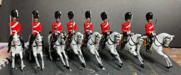

Hi All,
Been quiet as a toy church mouse fixing and painting this set.
I decided that I as three of the figures already seem to have attached arms, whether the correct arm or not, I didnt want to redo them as it would mean trying to prise them away from the flattened plug end. I presume that somehow, these group of 14 castings were acquired by a collector who tried to do up his own set but gave up. So I just hammered the arms tightly against the body to secure them. I then sorted out the remaining figures with suitable arms and attached these to make myself a nice squadron.
I didnt want to paint them exactly as original type Britains offerings but decided to add more details. Horses were painted first. The white horses were created greys with various spots. I made mine from flicking small drops of paint to create dappling. Black hoofs and grey stockings were added. Either white , grey or black manes were added and I also gave some pink snouts. All horse were given eyes. All reins and bits were painted. The figures were painted the usual black busbies, red tunics with dk blue cuffs and collars, white belts and gloves, dark blue trousers and black boots. Yellow trim added. Faces were given eyes and lips. The first pic below shows the figures after the final gloss varnish had been added. All paints were acrylics. I gave up on Humbrol enamels some years back as the paints kept spoiling prematurely in my kind of tropical clime. More pics will be shown after the paint has dried out and its safe to parade them....
Vic
