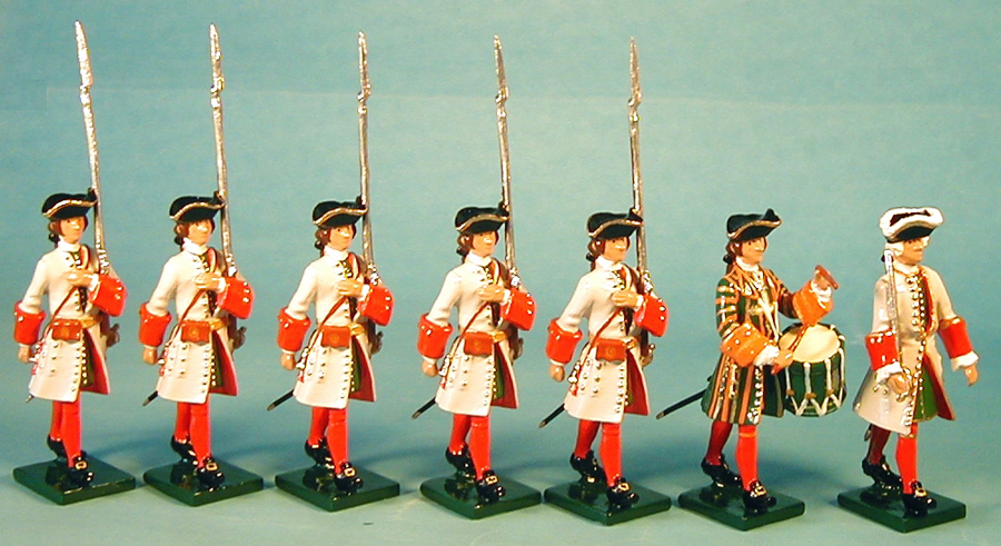

here he is a retired set by Beau Geste
John
