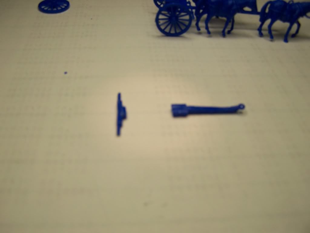

After much referring to the manual it looked to me like the trail of a cannon looked very much like the hitch and main pole of the caisson. The biggest problem was axle location. The Caisson axle is in line with what I'm calling the main pole and the axle on the gun carriage runs under the trail. Time for cutting. I first cut off the upper cheeks of the carriage and then cut the trail off even with the axle. I then trimmed off some excess and super-glued the two back together in line
Sorry for the poor picture but it serves well enough to show the two pcs. prior to gluing.

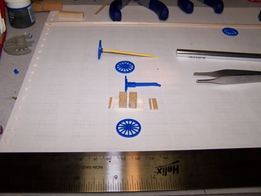

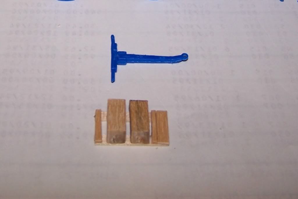

I then took my handy wooden coffee stirring sticks that I've been using to make 1/72 scale buildings and used them to make the bed of the caisson. I also cut some pine stock into the same size as the ammo chests on the limber.
The thinner wooden cross pcs. shown are just a stir stick split down the middle.
Then I set them on the plastic axle and poles just to see how they looked.

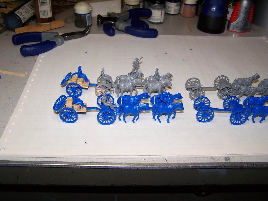

I then cut off a piece of a toothpick and glue it on to the rear crosspiece and stuck the spare wheel on it.
Then just put the finished bed onto the axle/pole.
I'm not sure the best thing to use to glue the wood to plastic. Any suggestions are certainly welcome. I want to wash and paint the plastic (except where they will be a glued together) before I go any farther. This is as far as I got today more pictures when painted and finished.

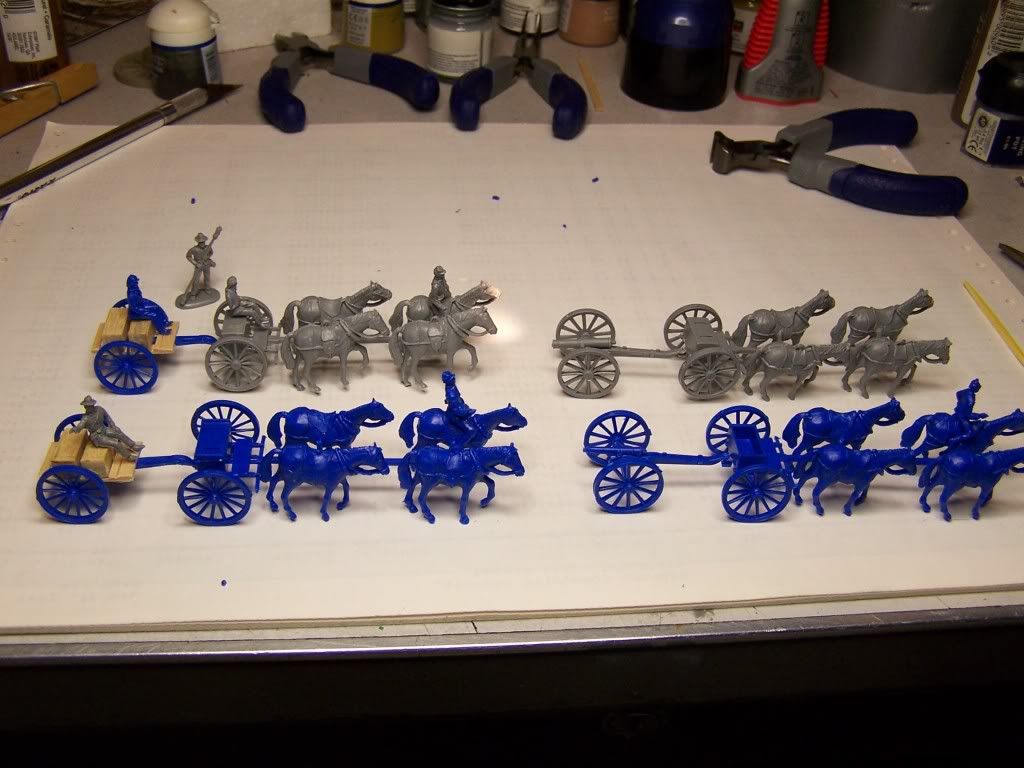

It took me alot longer to get these things painted up then I thought it would. Confounded Spring chores! Major John Pelham arrives to escort them to where most needed.
Thanks Britfarmer. I had fun doing it and was pleased with the way they turned out.
Photos and painted cassions look great. Thanks for the pictures and explanation on making the carriages. John
