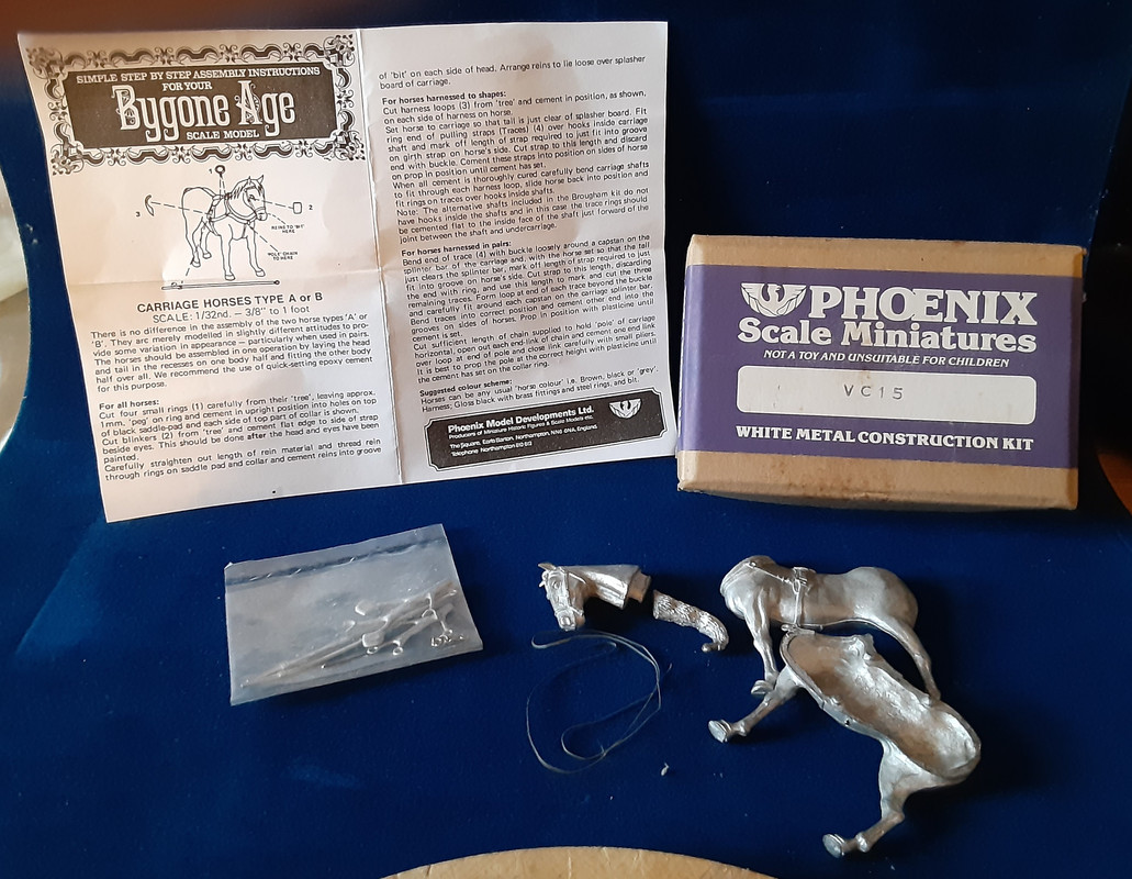

OK, here is a photo of the other horse kit that I got. As I laid out the kit for the photo, I opened the enclosed instruction sheet for the first time. It's branded for the Bygone Age range. I dug out my Phoenix catalogs, and found that VC-15 is "Carriage Horse type 'D'". So that 'splains that!
I should add that I've developed my own technique for assembling kit horses engineered in two halves like this: I use 2-part epoxy putty to fill the body and adhere the two halves. I hit on the idea with Imrie-Risley horses. Theirs are also tooled in two halves, with a plug where the saddle goes. Since I often fill that hole to convert the horse according to army, it occurred to me that the putty could "glue" the halves. I can also drill holes and run pins into the mass, for more strength.

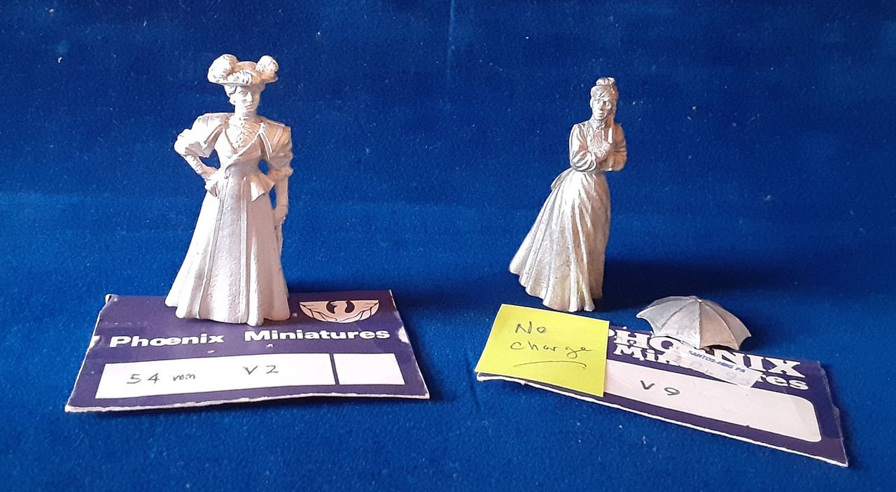

I also took a picture of the two ladies I got. These are (left) V2 "Victorian lady", and (right) V9 "Young lady (with parasol)":
The seller had two of each of these, so I bought all of them. One V9 kit was missing the parasol handle, so she was didn't charge me for that kit. That was awfully nice of her to do, and I will trade with her again. It's always nice to deal with people who are stand-up types. I mean, replacing the handle was nothing at all. Anyway, these will all go into my "Kaiser's Army/Berlin 1910" collection, as I finish them.
