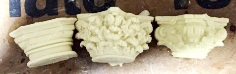

I've completed all the castings for pillar tops for my project. Here are examples of each of the three types that I wanted. I sculpted the masters and made bas-relief castings. These are intended for a shadow-box diorama.

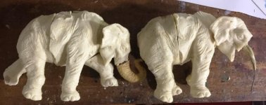

As can be seen, some work is required on the elephants. Here's WIP on one of them.

And here is the other elephant. As most of the basic assembly of the castings have been completed, I'll post further updates on the elephants in their separate threads.
