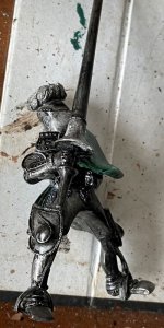

This was a more unknown maker. The figure represents a later jousting knight of the Maximilian period.
This kit is not for beginners. There is a lack of clear instructions on where things go. I had to review and check on how these mounted knights looked like during tournaments of the 15- 17th century.
these pics show that there is a mantle structure which is placed in front of the horse.
There are two foliage threads hanging down in front of the horse's face.
The wreath was placed around the horse tail and this created an unnatural gap on the back of the horse. This gap was filled in with putty.
The knight had a wreath on his helm. A shield was glued to the left arm. Before the right arm was added, a lance holder was glued to underneath the right arm on the armour. This was used to hold the lance steady and horizontal during the joust. The right arm had to be drilled out and fixed with a wire insert for strength and some flexibility.
When the knight was adjusted to sit properly on the horse, the right arm had to be adjusted to allow for this, hence the addition of a wire insert.
I noticed that the right side of the mantle was improperly cast with the top section missing. This was carefully sculpted in with putty. Finally, the reins were added to the horse and adjusted to allow the knight to sit properly on the horse.

Finally, I sprayed a grey undercoat on the horse to highlight any defects and to start the painting. For the knight, I'll just paint enamels on the non-metallic parts.

After numerous rounds of puttying and sanding, I finally painted a suitable green for the barding.

Here’s a simple glossy black paint wash over the metal cast knight.
