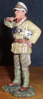

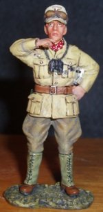

Colonel Fritz Bayerlein, Rommel's Afrika Korps Chief of Staff.

Colonel Bayerlein ponders his next move.

That's really great work Rick. I think people (myself included) would buy your work. I assume that's the Rommel figure which you then changed. Where did you get the head and how did you change the arm poses?

Brad. The Fritz Bayerlein figure is actually the Feldgendarmerie (military police) NCO from the AK “Checkpoint” set. Added new arm from another figure, and map and binos from a third figure. Removed the Feldgendarmerie gorget and square shoulder worn flashlight and scratch built the set of goggles using pictures of the ones Bayerlein wore. Can’t see it in the picture but the field cap is a whiter bleached out color more so than the tunic. Unlike many German officers, Bayerlein was not a flashy dresser and always wore a well worn sun bleached (all ranks) field cap and a regular soldiers issue field blouse with all ranks collar Litzen so the NCO figure was a good match. Bayerlein also wore the Iron Class 1st Class, Panzer Assault badge, and the wound badge on his field blouse so the decorations on the K&C figure also matched.
