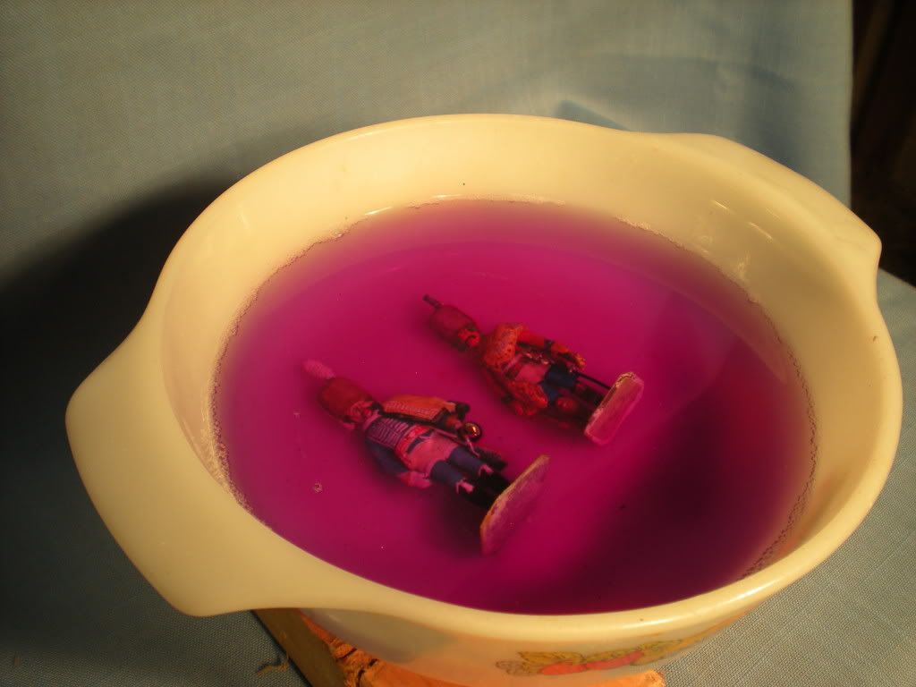

Here is a pair of Stadden Prussian hussars that I will eventually repaint, sitting in a bath of Super Clean:

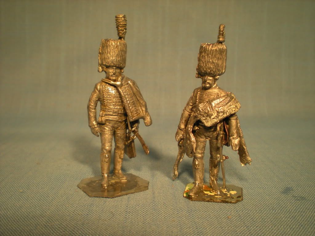

The de-greaser attacked the paint at once, bleaching it white, and I could see it was thinning off into the solution. I dipped an old toothbrush into the solution and scrubbed and noticed the paint was coming off. But I decided to let the figures sit, and see how long it would take for the paint to dissolve altogether. I came back an hour later, removed the figures and held them under running water. The paint literaly washed right off. Here is the result:
I only had to scrub a little at the figure on the right; there was some thick paint built up in some of the relief. But overall, this was astounding. And since it can be used as a drain cleaner as well, I poured the leftover Super Clean down the kitchen drain.

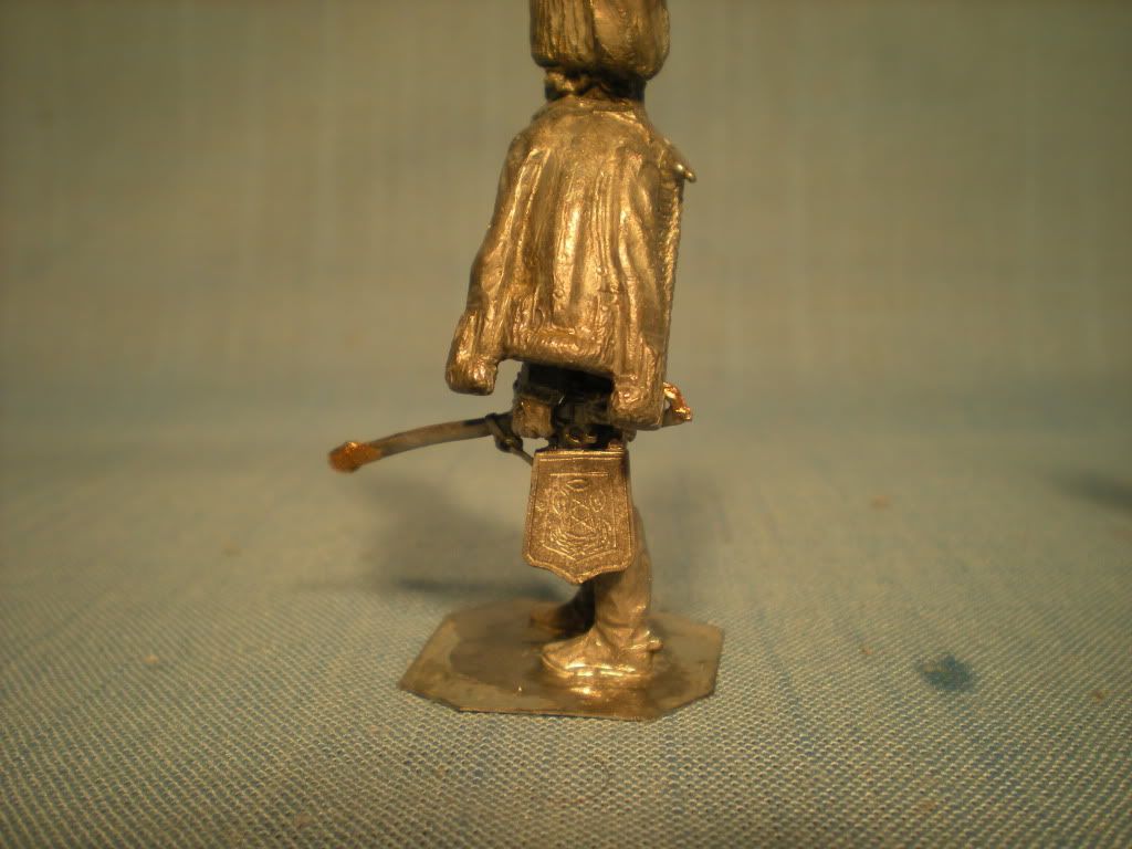

Here's one more shot of one of the castings, by the way:
Look at the detail on the Säbeltasche--it's amazing! The things you find under a coat of paint.....
