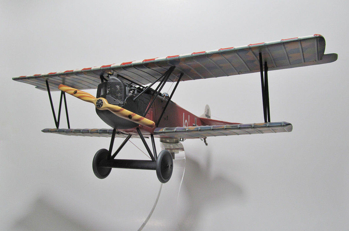

Step #1, take a picture of your model. Then, without moving the camera or model, rotate the prop 60-90 degrees and take a second picture:

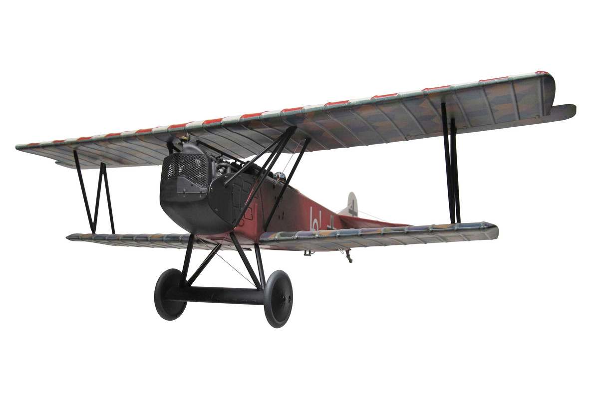

Step #2, import both images into Photoshop (or some other image editor), and delete the background from the first pic:

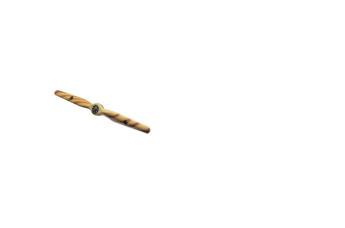

Step #3, Cut the prop away from the model and save it as a second layer. When you do so, you'll create voids where the prop was. Use textures from the other image, the one with the prop offset 60-90 degrees, to copy/paste the missing textures into the voids:
Here's the prop layer that was created in Step #3:

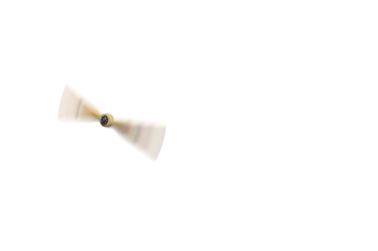

Step #4, using a Photoshop filter routine called "Spin Blur," set your prop in apparent motion:

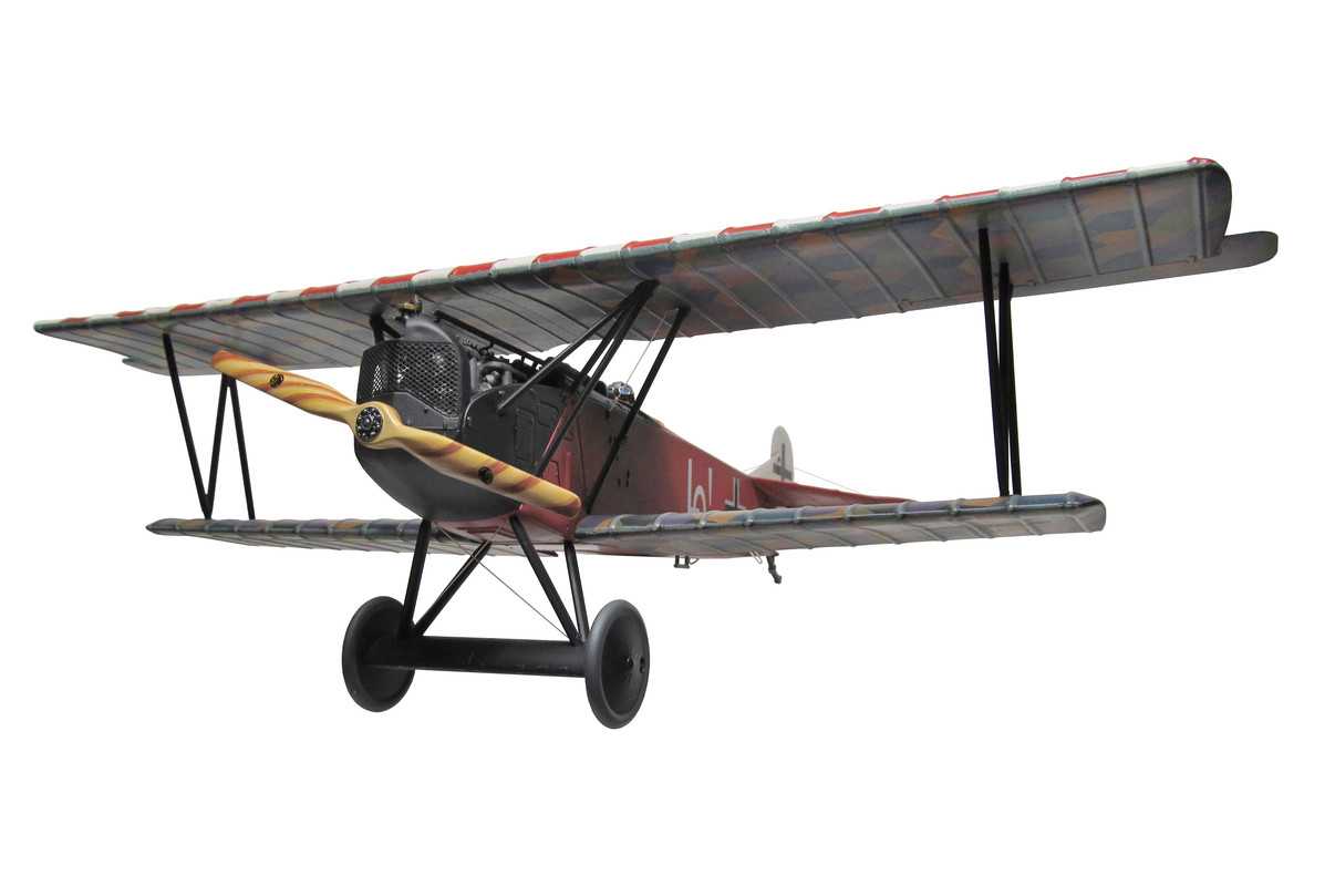

Step #5, make the prop the top layer and save both model and prop layers as a PNG file, one which will retain the transparent background that you created in Step #2:
