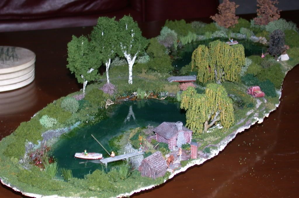

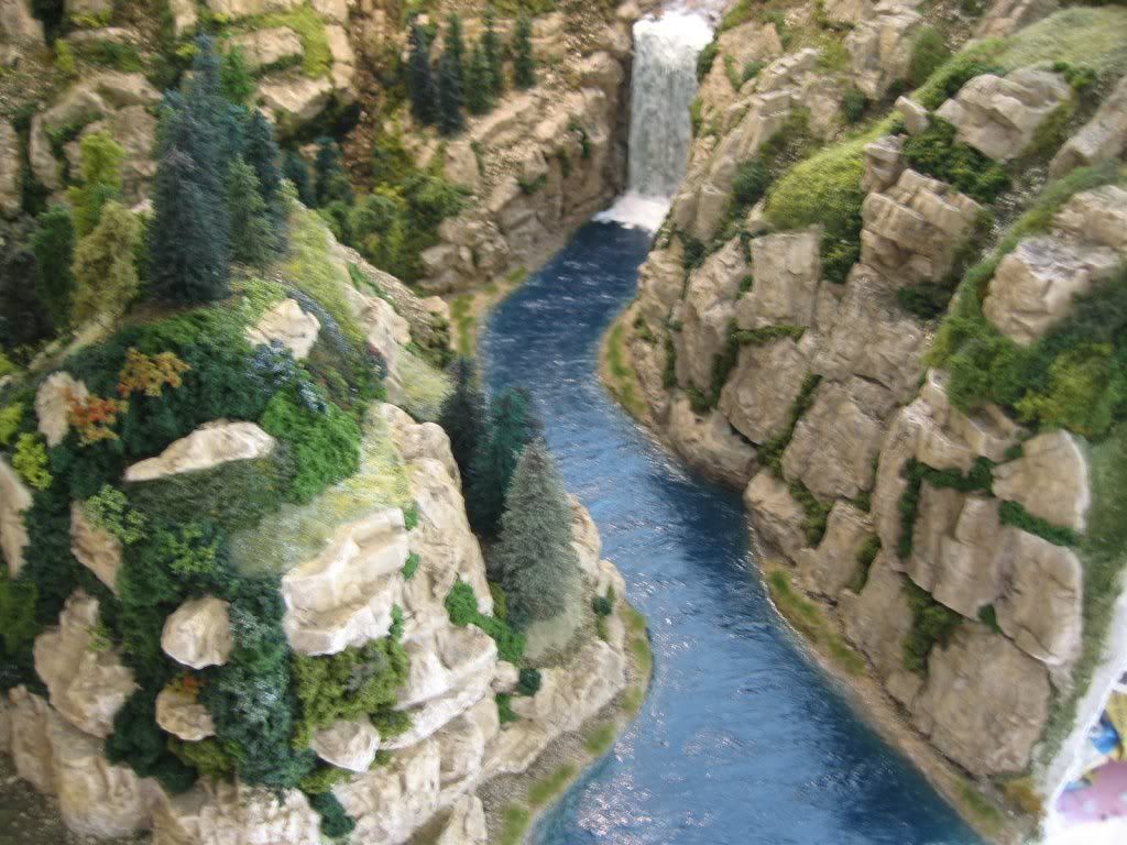

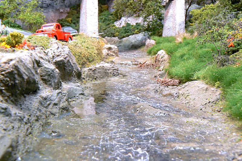

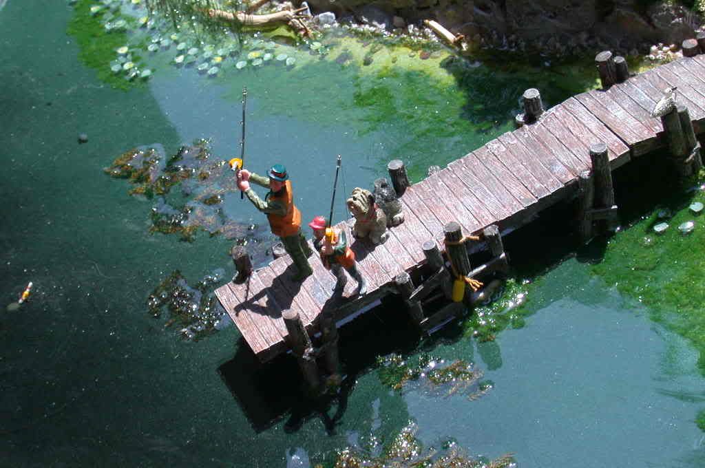

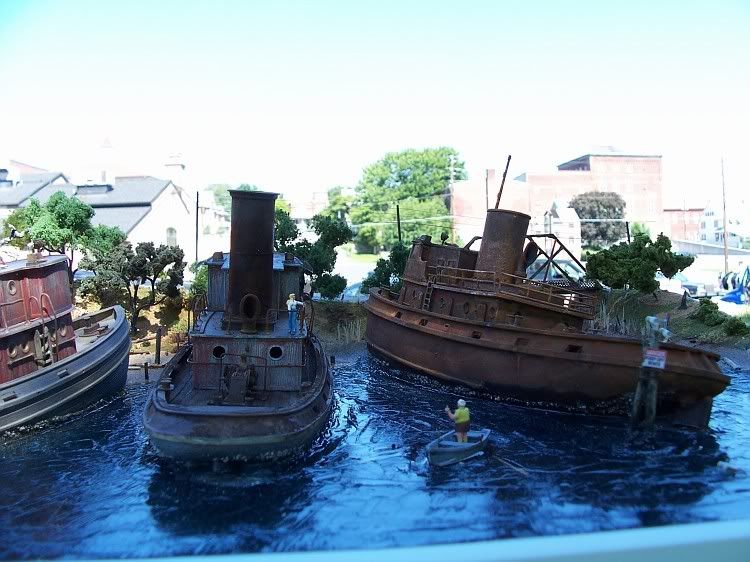

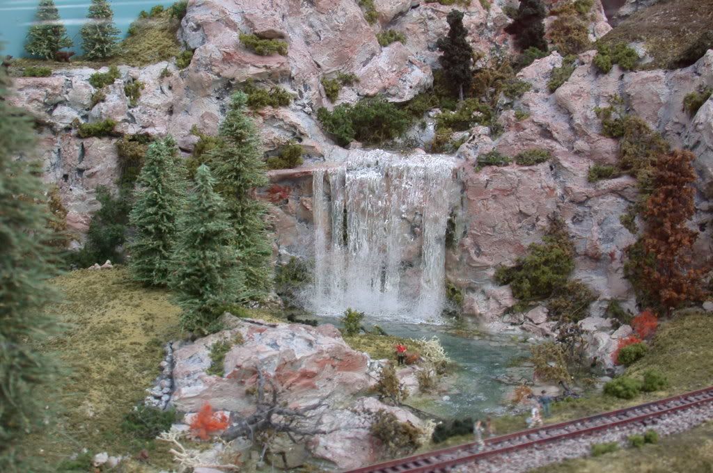

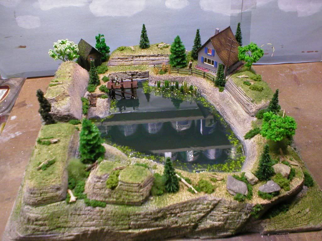

I'm going to try and post some of the photos of his water in dios if I can.
Most of these were done by David, all were done with his product.
