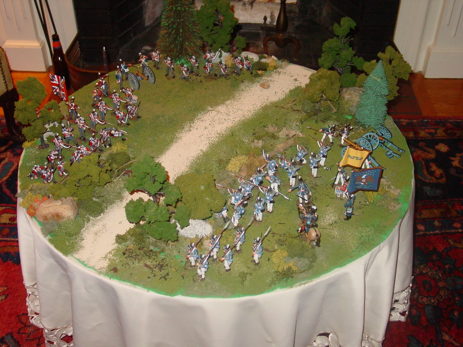

I use felt extensively as I continually rotate my displays (lack of space and also like to do small set ups at shows that need to go up and back down in short order) Felt sprinkled with all kinds of "yard" found and commercial ground clutter (to include snow) is easily laid out and more importantly very easily cleaned up and recovered for another day. The felt seems to hold the ground cluter in place so any heavy breathing brought on by the display doesn't necessarily cast it to the wind.

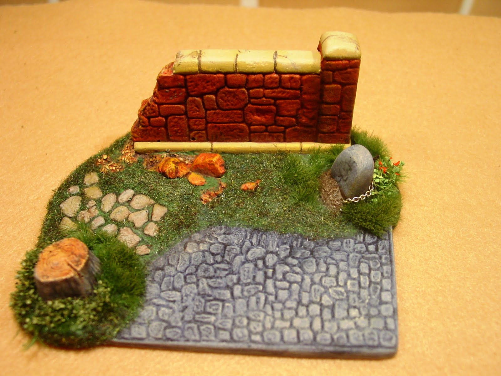

I have also made a number of "accessory" pieces that can be moved from display to display (photo here of one I made up this week to go with future artillery displays that is sitting on a piece of light tan felt) that sit on the felt and then the edges are blended in with the ground clutter. I use old credit cards or hotel keys to build these on as they are stong yet don't have to much of a lip to blend to the ground work. I have a number of other such accessories if anyone would like to see further photos and description how they were made.
In addition is a larger table display set up in the living room of a fellow collector (who has a SAINT for a wife when it comes to TEMPORARY displays in common living quarters), and you will note by looking at the edges sits on green felt..........nothing permanetly attached, and cleans up mess free in no time.

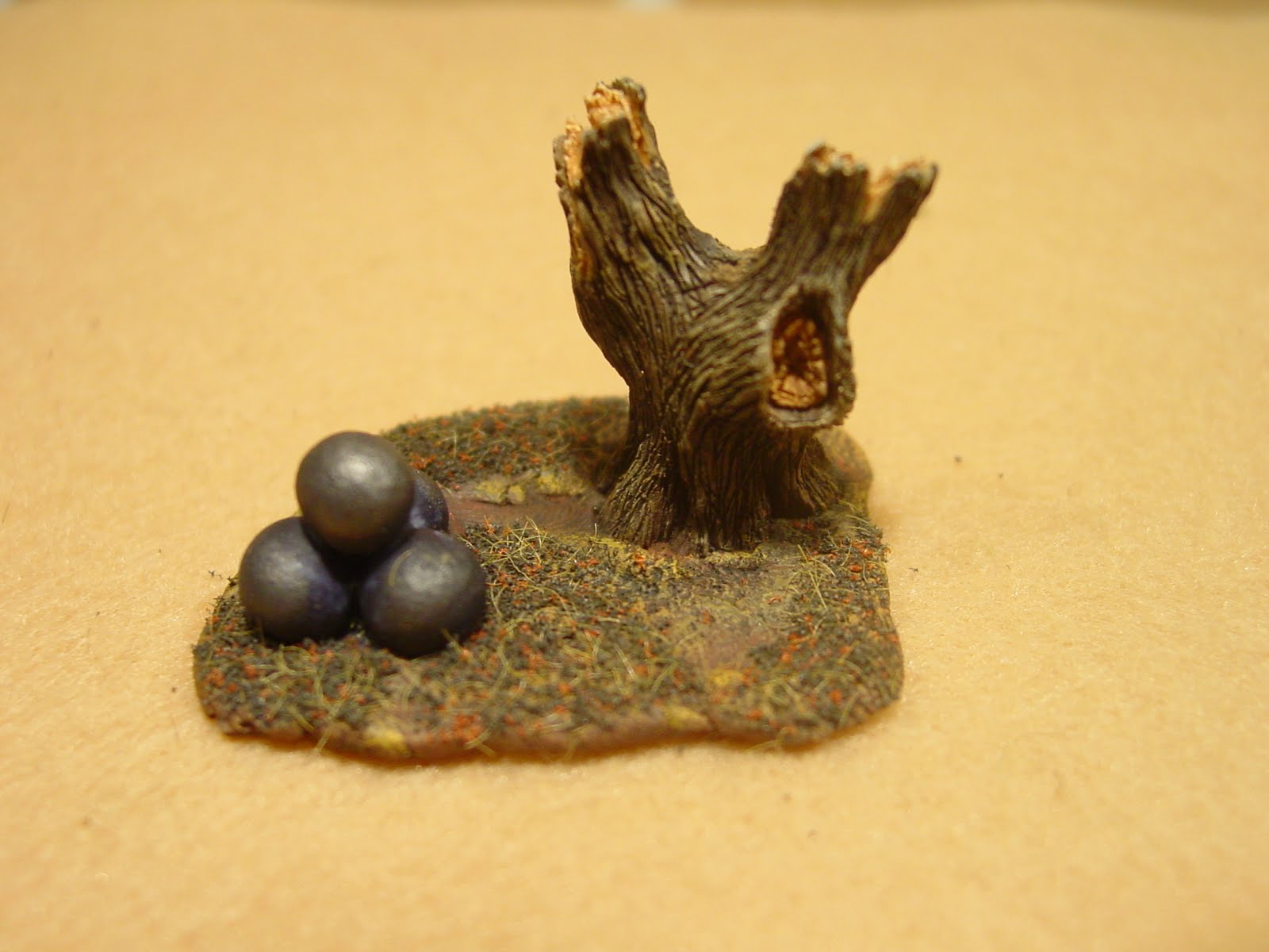

Reference above here are a few more accessories I made in the past that I use to add interst to vignettes and displays with commerical figures. I blend these in with temporary ground work on the felt base.
Description of the pieces to include the cannon balls and stump from an earlier post.
-fowl on the spit which is from an old Historex kit from the 80”s
-photos however also bring out the finger prints still in the putty that unfortunately can’t always be seen with these old eyes at time of construction.
-Fire smoke from very fine steel wool, black wash at the base, white wash at the tip
-Fire: Black base, then red to the tip of flame. Orange wash 25% up to tip (little red shows through). Yellow paint at tip. Dashes of yellow in lower parts of flame with red wash over that.
Seems to work, or at least from a distance
-Tree stump from Armand B., cannon balls from rolled putty painted black then highlites rubbed with pencil graphite on finger tips
-Used credit cards as the base, then build up with putty. Keeps base a low profile for ease of blending into surrounding ground work
-All grasses and shrubs from Xpress. Note Military Warehouse also carries the landscaping stuff as well as an excellent selection of Armand B. tree trunks
-The base with the soldier (Gordon Highlander from Napoleonic era by K&C) was a plaster casting I picked up for 50 cents while bottom fishing at the Long Island Show.
-Little paint and some grass work (and added chain to the horse
hitching post) and it came out pretty good for staging a figure
