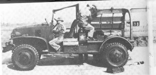

The reference photos for the project...please scroll down and read on.

Not sure if a bomb was carried onthe back panel as seen on some re-enactor photos. The M6 was only equipped with a hoist and no way can it "roll in" the bom b on the rear panel unless lifted by hand. In historical photos I've seen, the M6 pulled the M5 Bomb Trailer (or the M22 liftt truck for attaching torpedoes and heavier loads) between ammo dump and the airfield. The M6 carried the M1 lift truck as an accessory and is loaded behind the bench.
