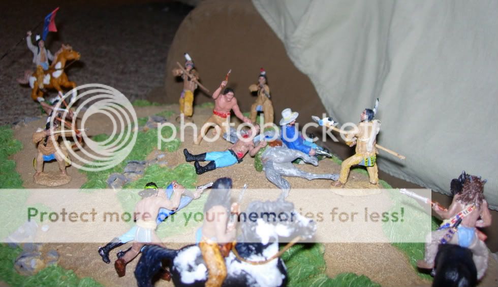

Hi Baron
Here are a few pictures from my photobucket album.
These are some conversions and painted guys.
I usually use plastic figures.
