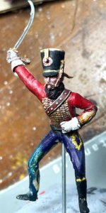

This ptg is very detailed and the focus is on Col Berthe. This is where I try to bring this figure up a notch.
The shabraque was further covered with putty and reshaped.
The horse neck has prominent muscles on both sides of the throat. Added more mane. The head and shako was built up in stages. Once I was satisfied with the shako shape, I added details.
A mameluke sabre was carefully added to the right hand which was resculpted. A tassel was added to the back attached with a tiny wire.
The fig and horse were worked on separately. the last pic is quite satisfactory to me.

I redid the left arm and bulked out the shabraque pommel to get the juxtapositioning right. Added more mane.
Added tiny buttons to the pouch belt. Will trim down the right glove before I start the ptg. Other details will be added later.
Now adding the basic details. The straps, headstalls and nose band are covered with white studs. Ive added some historex items and the tail has been added.
I propose to add the mameluke like decorations then paint fully, then add the more complex head decorations.
You need the patience of a saint to do this fiddly work. Saint inity....hahaha.
Painting the figure in oils. I dont really bother with the hidden side. I had fun with the teeny highlights and the braiding.
Some minor resculpts to be done on the gloves, right hand lacing, chin strap and highlight the pantaloons.

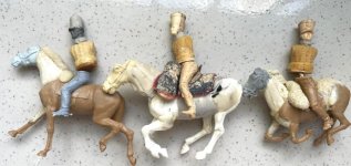

Adding the heads to the hussar torsos. Airfix and Wolf Miniatures head {metal}. The torsos are my own home made resin castings.
Horses are the usual mix of historex and 1/35 horses. Ive lowered the back of the white horse drastically and created a belly for it.

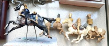

Here are the rest of the main supporting cast. I'm trying to use mostly 1/35 scale horses here to speed up the work. The next batch will be a resizing down towards 28mm horses.
The front row two horses are in line with Berthe. The bugler is in line with the tall shako figure. The back three mtd figs are behind.
Im using up the remaining stock of my resin torsos. But I cut them down at the sides and shorten them. I am also attaching smaller heads or cut down heads.
The process ain't pretty but you lot aren't fussy, either....hahahahaha.
Here are the three back horses and figs. I have fixed their poses. Now, I will have to reduce their overall sizes to fit in with each other and also to fit into the proposed shadow box space.
One obvious way is to shorten the horses' lengths.
