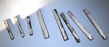

My farm needs a gate
I will explain how to make one
Picture 1 : cut some balsa wood strips to the exact measurements you need for your dio ( this is half a gate of course)
Picture 2: give the strips a coat of burnt umber, when dry give them an extra coat of grey: first use medium grey and end with light grey ( to obtain some colour variations)
When dry soak the strips in White Spirit ( this is very important it will make it very difficult for the upper coat of paint to stick to the wood) , then give them a coat of green . I used flat green and olive green ( you can use whatever colour you want of course)
Let it dry for a max of 5 minutes. Then with some sticky tape take some of the upper green coat away ( the result will be: chipped paint)
Finally give the whole structure a coat of slightly deluted black ink and glue it together
In picture 3 you can see the end result .
repeat the same for the other half of the gate
guy:)
guy:)
