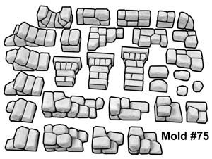

my favorite mold right now is #75...the "ruined fieldstone mold"...it works so good for exposed damaged brick...look at some of the "collapsed roof buildings I did...that is a nice mold...
